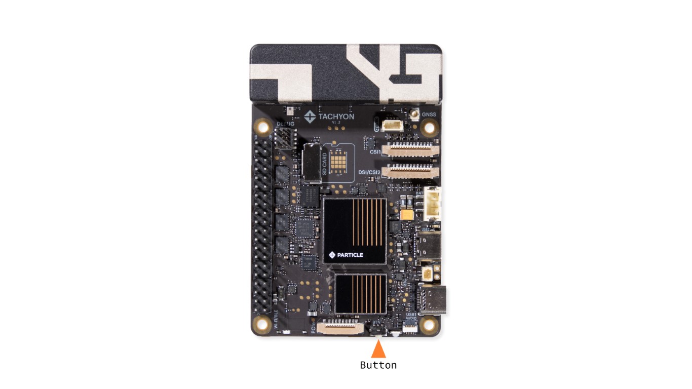

The Tachyon board has a single button (label 18) located next to the primary LED. This button controls various device states and provides the following functionalities:
Button ActionResult
Quick Press (from power down mode aka red led)The device powers on, and the LED flashes green as Linux boots.
Hold for 3 seconds (from operating mode)The device immediately shuts down, disconnecting power and returning to power off mode.
Hold for 3 seconds (from power off mode)The device enters programming mode after 3 seconds and the LED flashes yellow.
Quick Press (from operating mode)The device sends a message to suspend the device. Weston or Gnome3 respond to this and turn the LCD off.
Quick Press (again from low-power mode)The device wakes up and resumes operation. Again, supported by Weston / Gnome3

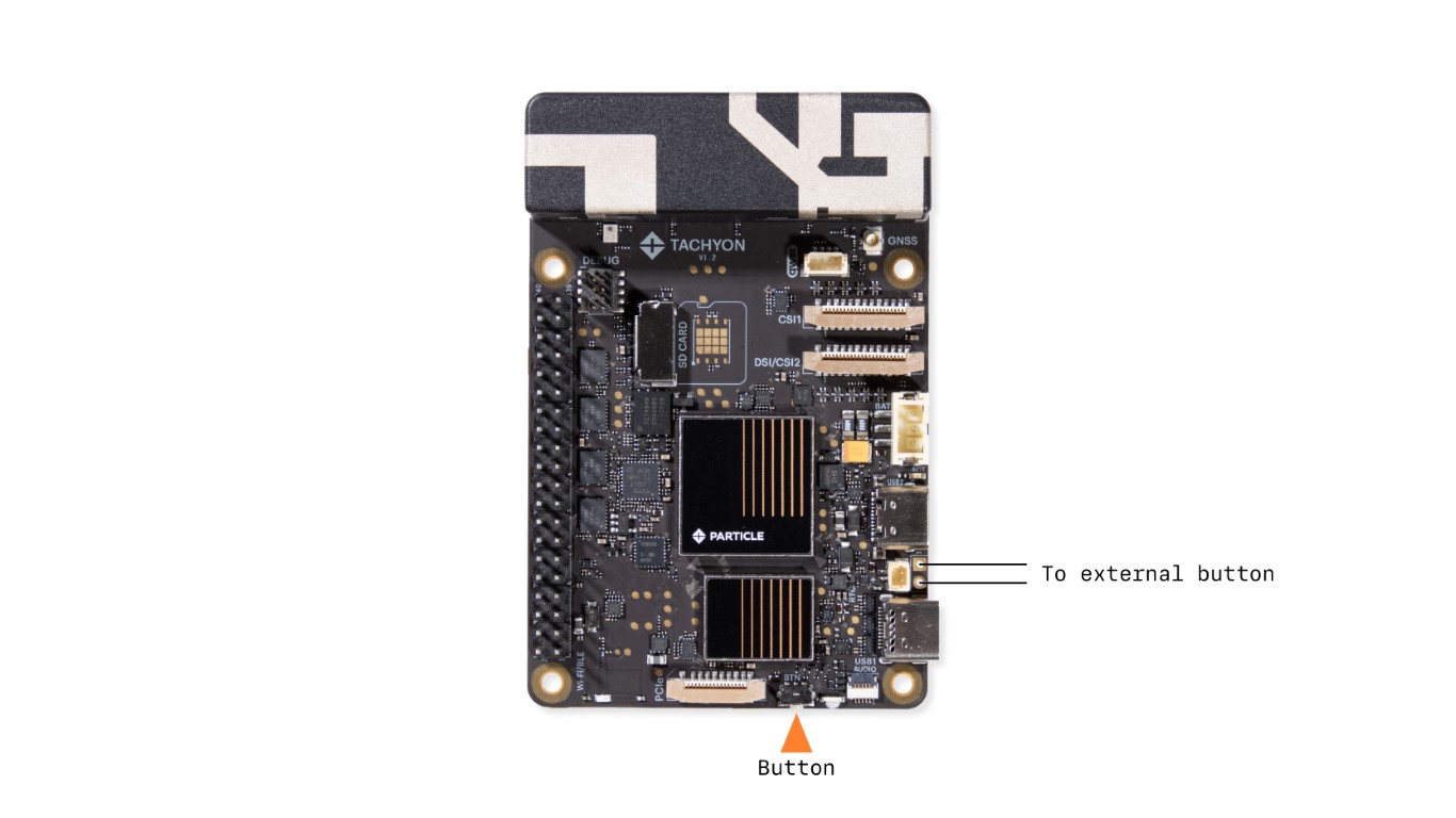

Connecting an External Button
If you wish to connect an external trigger or button, solder pads are available as shown in the image below. These pads are connected in parallel with the main button, allowing both to be used simultaneously as needed.
