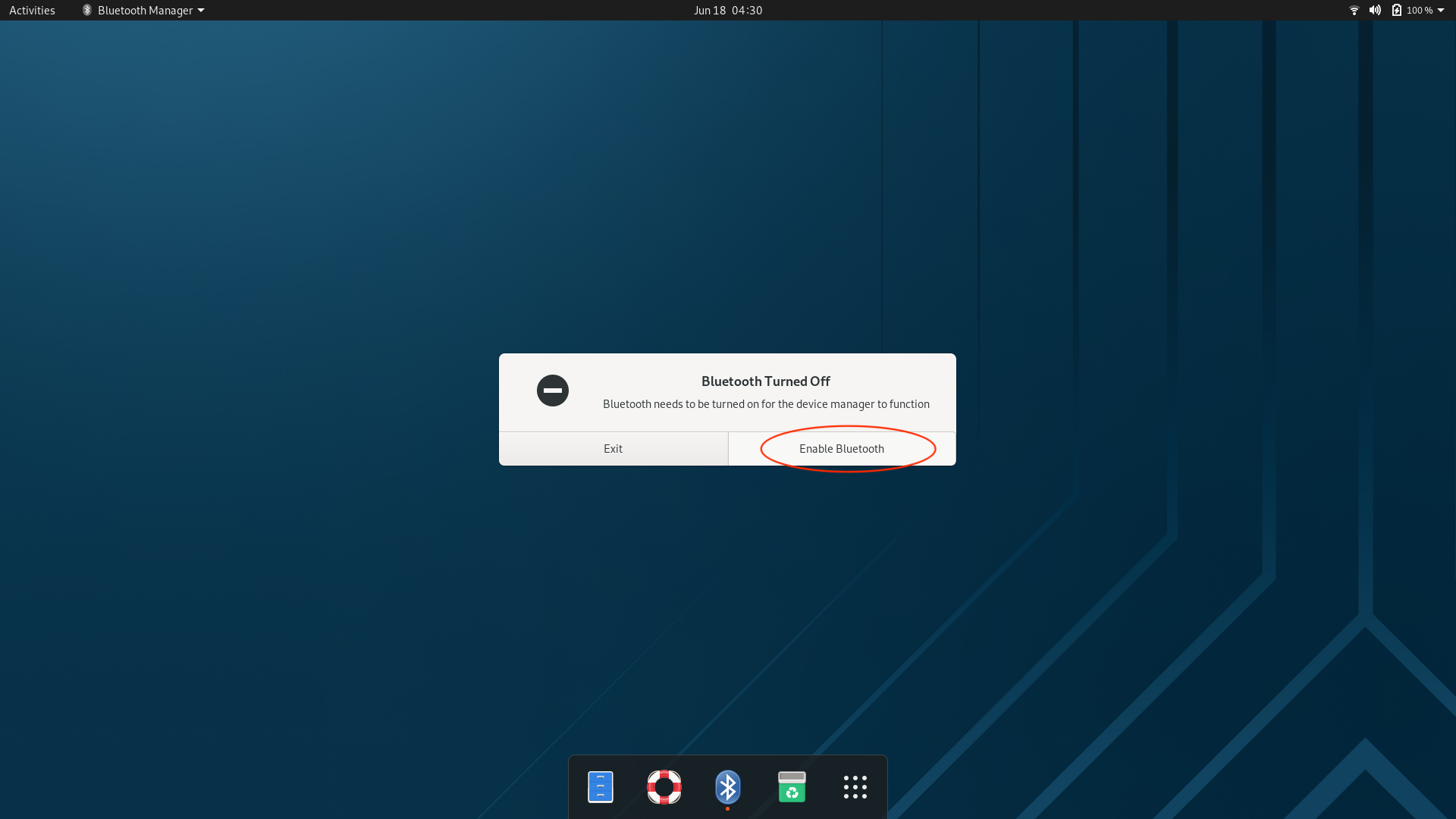

On first boot, blueman will ask to auto turn on bluetooth, click accept and yes
Bluetooth turn on Bluetooth turn on
There may be an issue on first setup of the bluetooth controller scan failing. If this is the case, restart the HCI connection via sudo systemctl restart hciattach and retry scanning. This is a known issue and will be investigated.

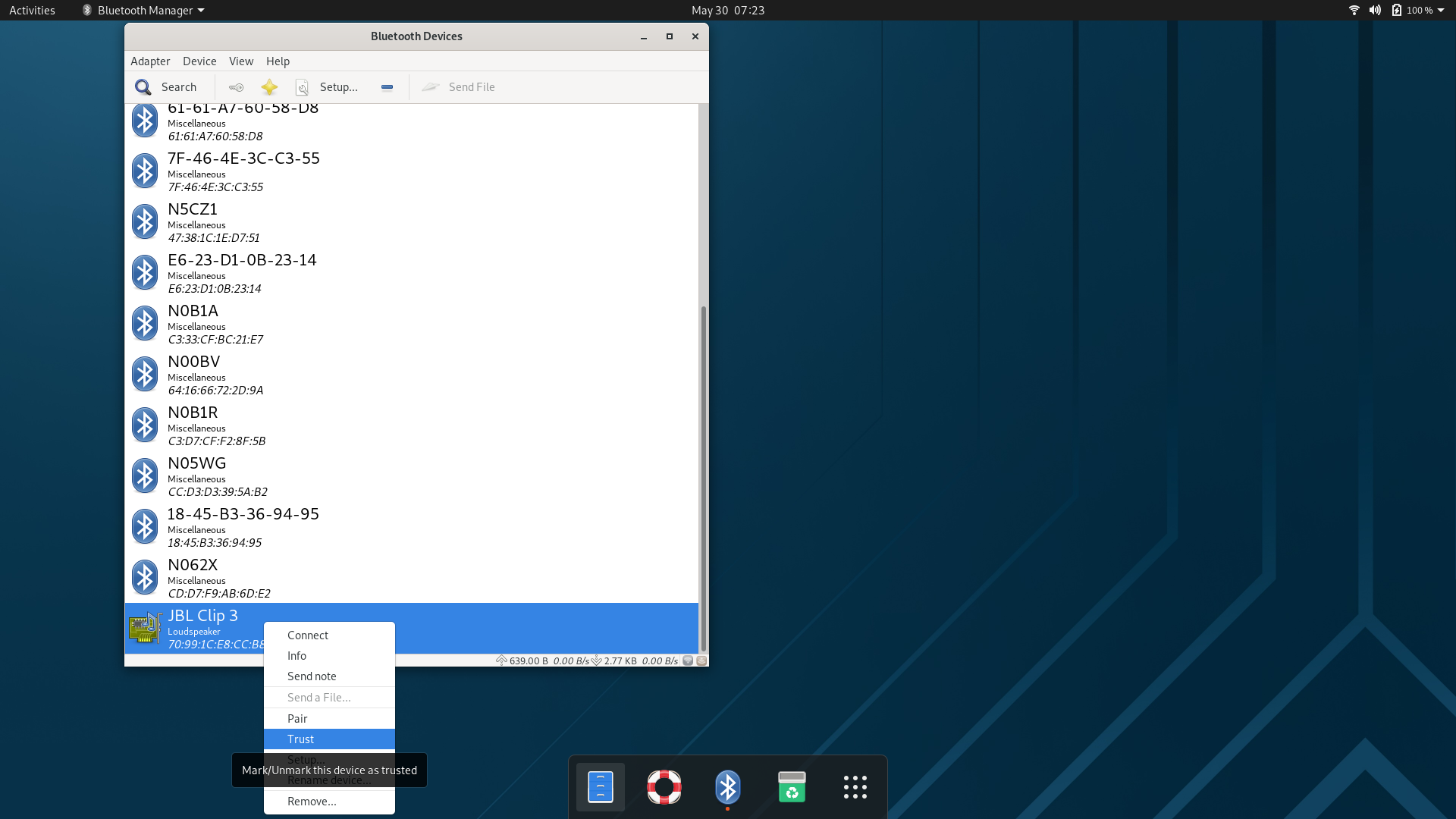

Place your device in pairing mode and scan. The device should be populated in the list.
Bluetooth turn on

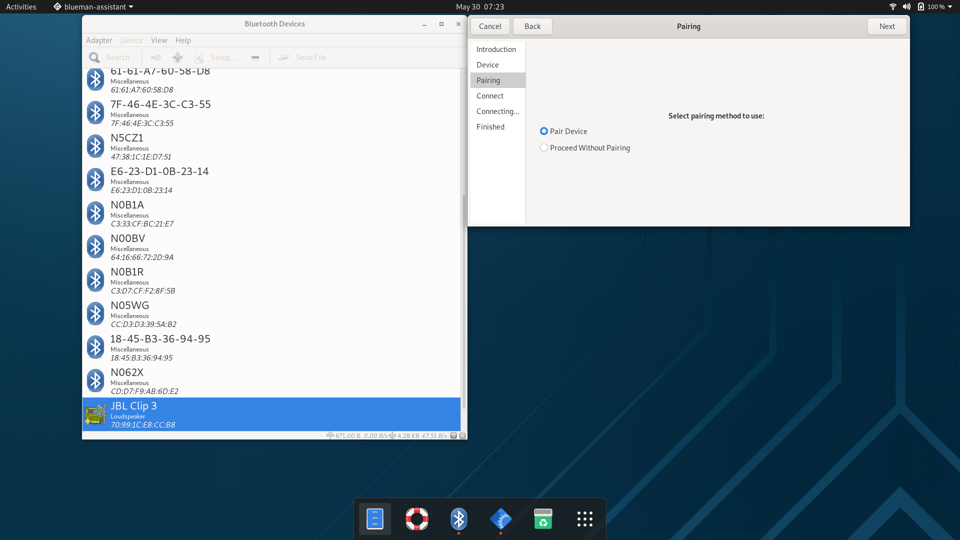

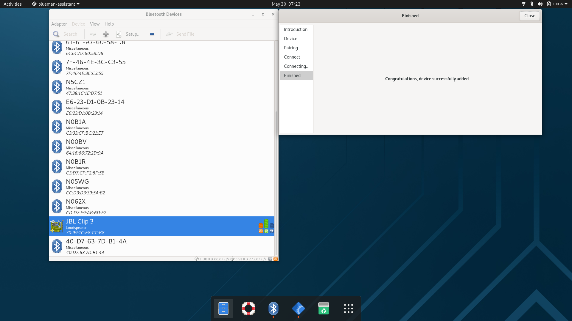

Connecting to the device can be done with right click menu options or using the setup button and following the prompts
