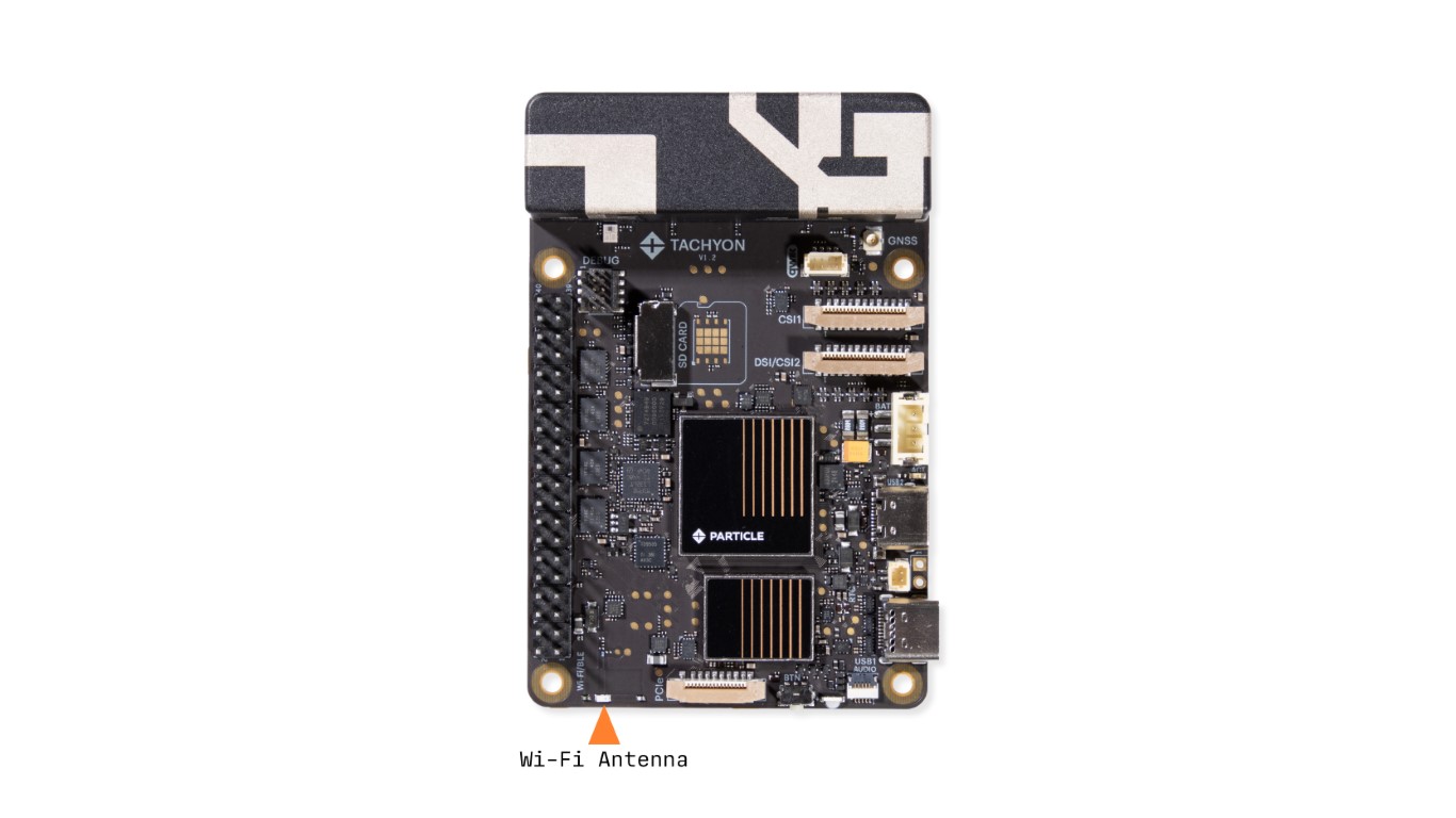

🛠 Hardware & Interfaces
The Wi-Fi module is connected via PCIe, ensuring high bandwidth and reliable performance.
