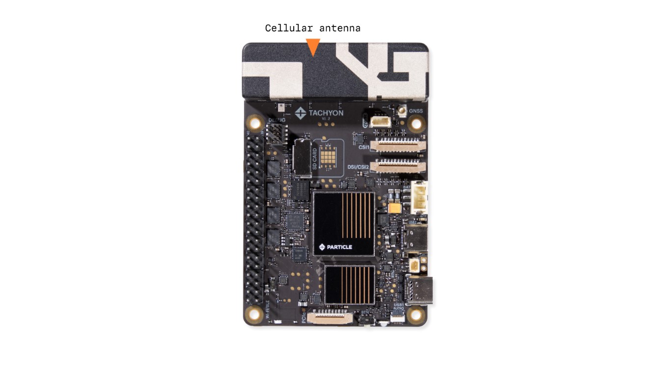

Antenna Configuration​
The Tachyon board features a built-in 5G sub-6GHz antenna, which is directly connected to the modem. Currently, 0external antenna support is not available, though an adapter exists internally (but has not been publicly released).
Desktop Setup
💡 Antenna Optimization We use various combinatorial technologies to mux multiple antennas together, ensuring the best possible performance while reducing the antenna size.
