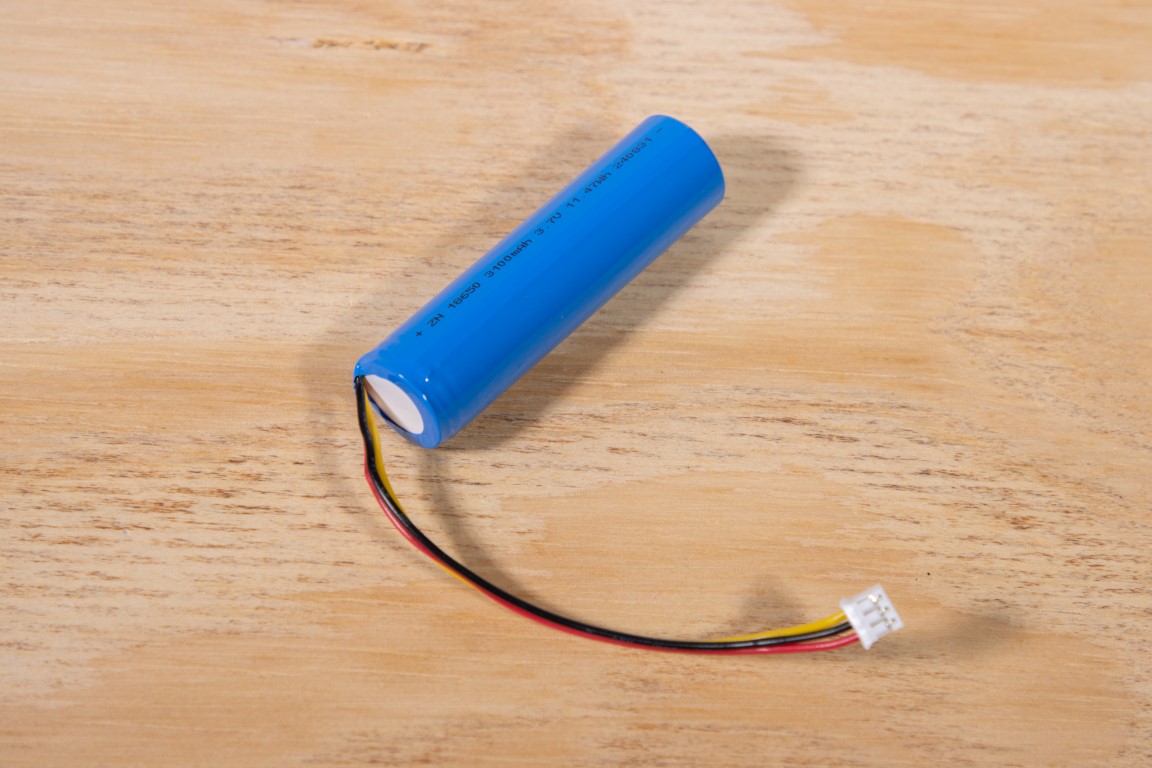

Single-Cell (1S) Li-ion Battery​
1S Tachyon battery
Kickstarter backers receive a custom 1S lithium-ion battery built specifically for Tachyon. This pack uses a 3-pin connector:
  • + and – terminals for power
  • T for temperature sensing using an integrated 10kΩ NTC thermistor
Tachyon’s PMIC monitors this thermistor in real time and dynamically adjusts the charging profile to keep the battery safe — including full JEITA compliance for charging at extreme temps. Even a deeply discharged battery is safely revived using a trickle charge mode.

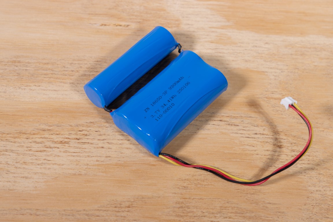

Three-cell Battery Pack (3P)​
3P Tachyon battery
The M1 enclosure kit includes a 3-cell parallel (3P) battery pack for extended runtime and higher capacity applications. It uses the same 3-pin connector and thermistor setup, ensuring consistent thermal monitoring and protection.
Tachyon’s smart PMIC supports differential battery sensing for accurate voltage readings and can enter supplemental mode — drawing from the battery to boost system power when needed. It also manages both USB and DC input sources with fast handoff, overvoltage protection, and programmable current limits.
