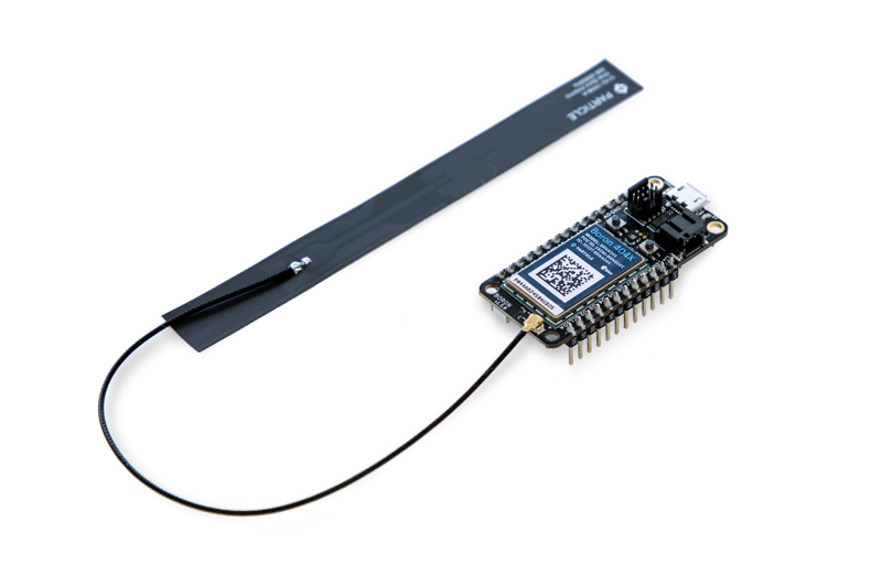

  1. Connect the cellular antenna to the Boron’s u.FL connector.

Boron antenna
