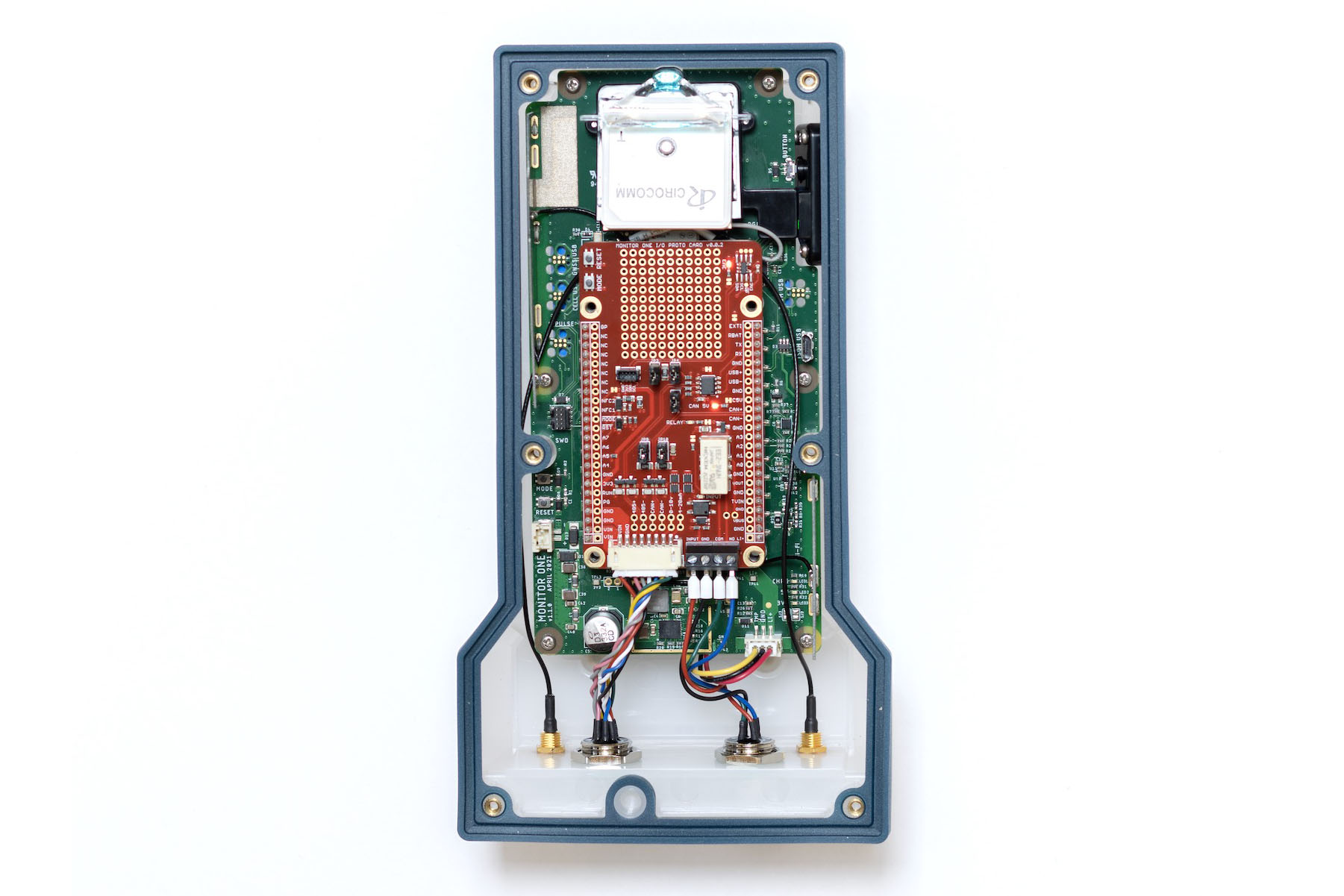

Monitor One Open

  • (Optional) Micro USB-B cable & hex wrenches (for opening the case or installing extras)
