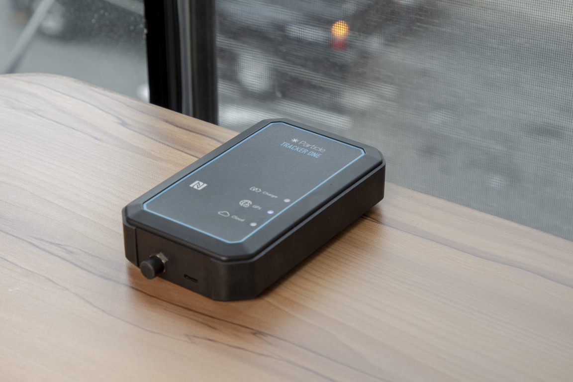

Tracker One Setup
Get your Particle Tracker One up and running in just a few steps. This guide covers powering on the device, connecting it to your account, and understanding the key indicator LEDs.

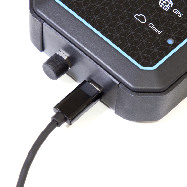

Powering On the Device​
The Tracker One ships in shipping mode to preserve the battery during transport. The device does not include a power button. To wake it from shipping mode:
  1. Connect the USB cable to your Tracker One.
  2. Plug the other end into your computer or a dedicated USB power supply.
M1 Kit box
This will power up the device and begin the startup sequence.

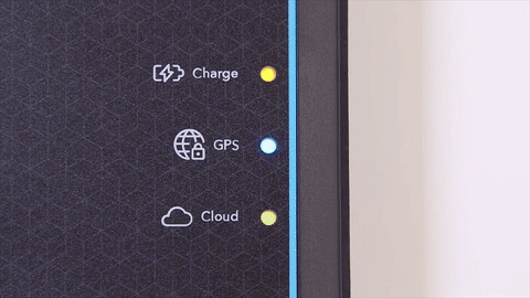

Understanding the LEDs​
Once powered on, the Tracker One uses LEDs to indicate status. These indicators help you understand charging state, GNSS (GPS) connectivity, and cloud connection.
M1 Kit box
Charge LED (Yellow)​
Indicates the status of the battery charging circuit.
  • Off – No charging or no power
  • On – Battery charging
  • Blinking – Charging fault
  • Flickering – No battery connected
GNSS LED (Blue)​
Shows the status of the GNSS receiver.
  • Off – GNSS powered off
  • Blinking (1 Hz) – Attempting to acquire a satellite fix
  • Solid On – GNSS fix acquired
Cloud Status LED (RGB)​
Indicates cellular and Particle Cloud connection status.
  • Red Breathing – Connecting to cellular network
  • Yellow Breathing – Connecting to cloud (weak signal)
  • Green Breathing – Connecting to cloud (good signal)
  • Yellow Solid – Connected to cloud (weak signal)
  • Green Solid – Connected to cloud (good signal)
