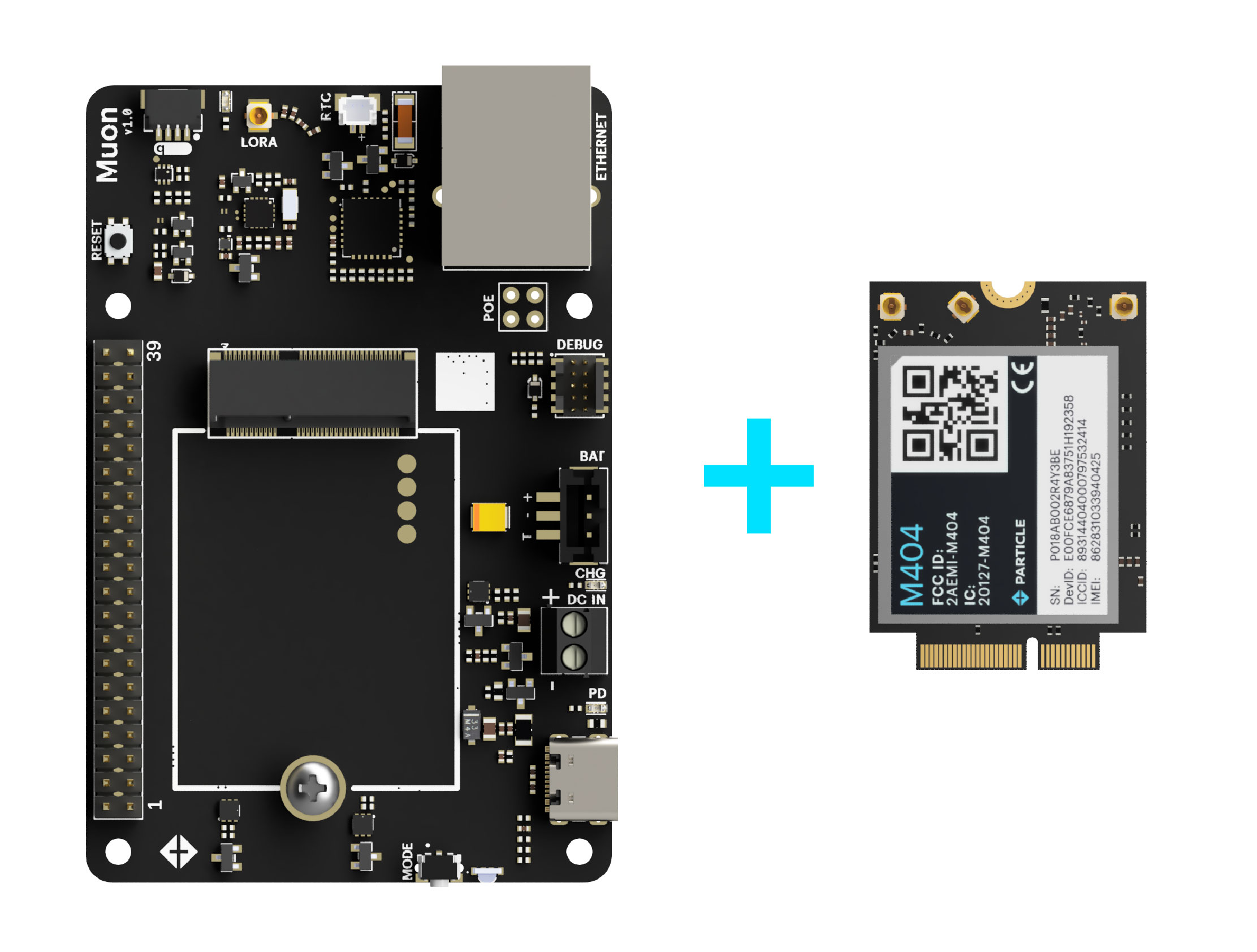

The Particle M-SoM can be set up in two different ways, depending on your development needs. You can either install it on a Muon carrier board for a plug-and-play experience, or use the M.2 SoM breakout board for maximum flexibility when evaluating and designing custom hardware.
  • Use the M.2 SoM breakout board if you want full access to the module’s interfaces for evaluation, prototyping, or early product design.
  • Use the Muon carrier board if you want a ready-to-use development kit form factor to quickly test connectivity and application code.
Using the M-SoM with Muon​
M404 Muon
Refer to the Muon setup guide for detailed instructions on getting started with the M-SoM when paired with the Muon carrier board.
