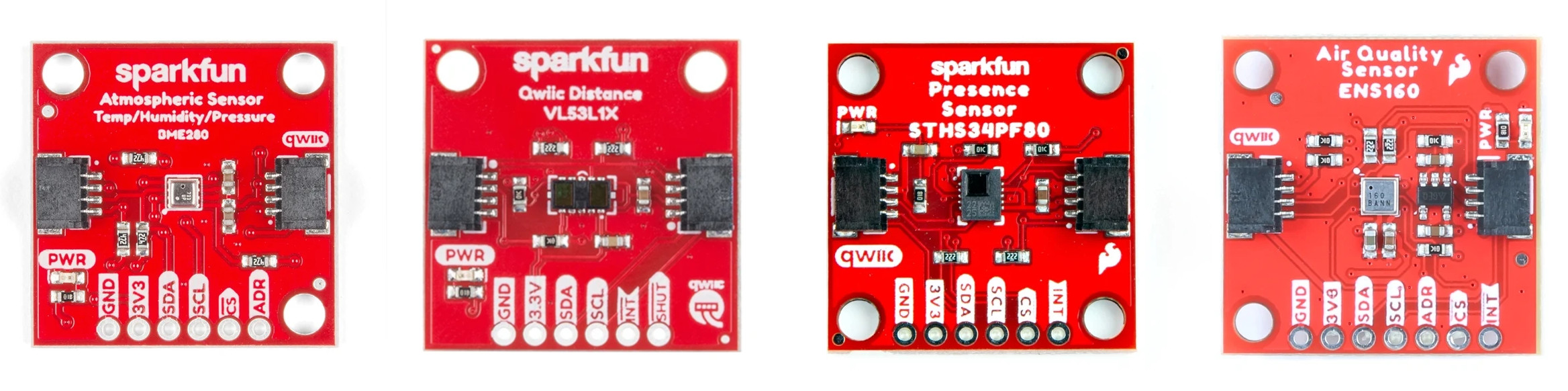

SparkFun Qwiic Sensors
The SparkFun Qwiic Sensors lineup offers an easy way to add motion detection, environmental sensing, and distance measurement to your embedded projects. All of these sensors feature the Qwiic Connect System, allowing simple I2C daisy-chaining—no soldering required.
SparkFun Qwiic Atmospheric Sensor
This sensor integrates temperature, humidity, barometric pressure, and sometimes gas resistance sensing into one compact board.
Key Features
- Bosch BME280/BME688 sensor (model-dependent)
- Measures Temp / Humidity / Pressure
- Optional IAQ and gas sensing
- Qwiic I2C Interface
Reference
SparkFun Qwiic Distance Sensor
Highly accurate time-of-flight (ToF) distance sensor using laser-based measurement (VL53L1X or similar).
Key Features
- Ranges from 4cm to 4m (sensor-dependent)
- Fast and accurate ToF distance readings
- Interrupt and shutdown pins
Reference
SparkFun Human Presence & Motion Sensor - STHS34PF80
A powerful human detection module built around passive infrared (PIR) and/or presence sensing using technologies like mmWave or radar (variant dependent).
Key Features
- Human presence detection and motion sensing via PIR or radar.
- Configurable distance and sensitivity thresholds.
- Low-power operation suitable for battery-powered systems.
Reference
SparkFun Qwiic Indoor Air Quality Sensor
Designed for monitoring indoor air conditions including volatile organic compounds (VOCs) and CO₂ equivalents.
Key Features
- Sensirion SGP30 or SCD40/41 sensors (varies)
- Measures TVOC, eCO₂, and sometimes temperature/humidity
- Pre-calibrated and ready to use
Reference
