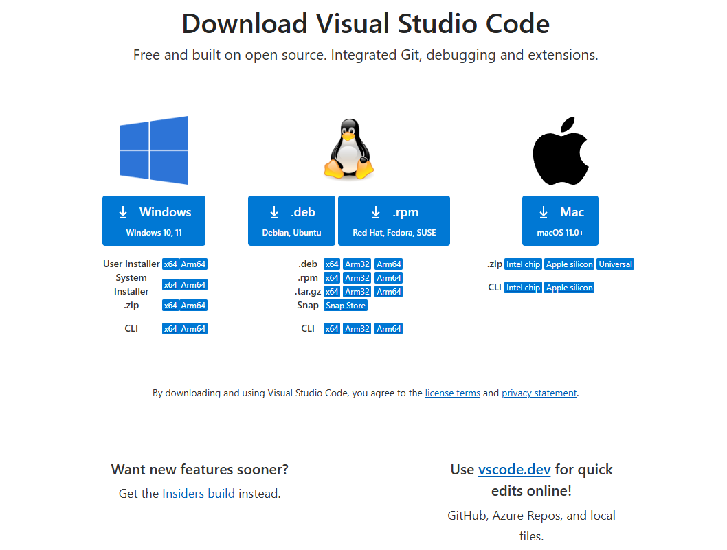

1. Install Visual Studio Code​
Workbench VSCode

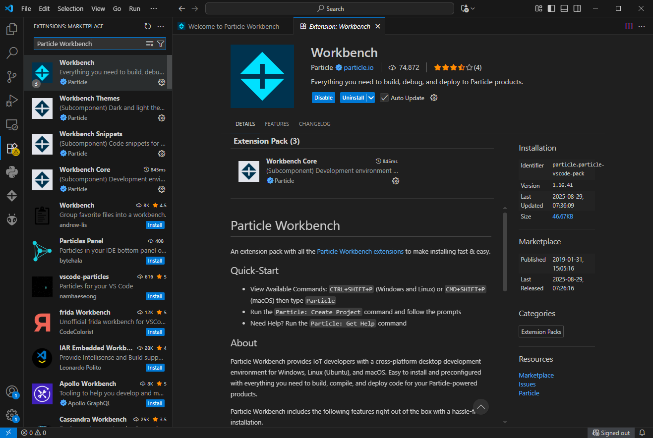

2. Install the Particle Workbench Extension​
  • Open the Extensions Marketplace in VS Code (Ctrl+Shift+X / Cmd+Shift+X).
  • Search for Particle Workbench.
  • Click Install to add it to your environment.
Workbench Install
( Here is a direct link to the Particle Workbench extension pack for your reference.)
