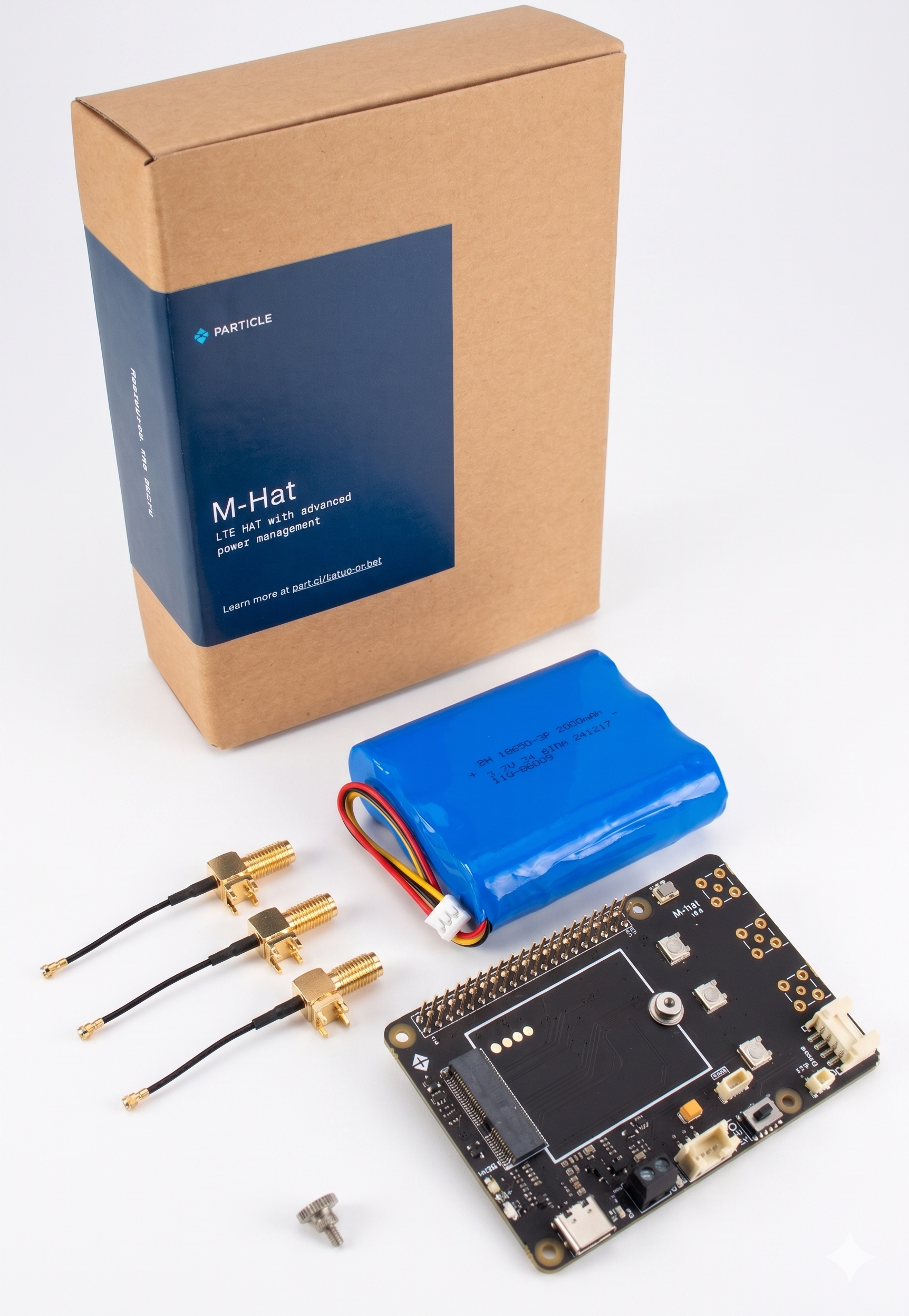

M-Hat box and contents
Inventory​
ItemDescriptionUsage
M-Hat boardThe main Particle HAT boardCarrier board for the Particle SoM. Provides cellular connectivity and power management for your Raspberry Pi
3-cell LiPo battery3.7V LiPo with 10K NTC thermistor, 3-pin JST-PH connectorPowers the M-Hat and Raspberry Pi when no USB-C or DC supply is connected
3x SMA to U.FL adaptersPigtail cables with SMA connector on one end, U.FL on the otherAllows an external SMA antenna to be connected to the U.FL connectors on the installed SoM
M.2 thumbscrewSoM hold-down screwSecures the Particle SoM in the M.2 slot on the M-Hat
