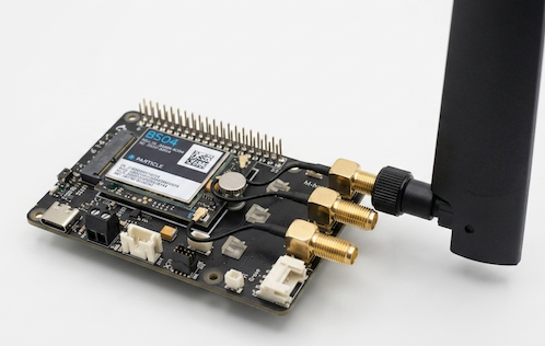

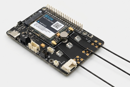

- Connect an antenna to the SoM's cellular U.FL connector. A cellular antenna is required - the SoM will not connect to the network without it. You have two options:
- U.FL antenna (included with the SoM) - connect directly to the SoM's U.FL connector
- External SMA antenna - solder the SMA to U.FL adapter to one of the mounting locations provided on the M-Hat, then connect the U.FL end to the SoM's U.FL connector
