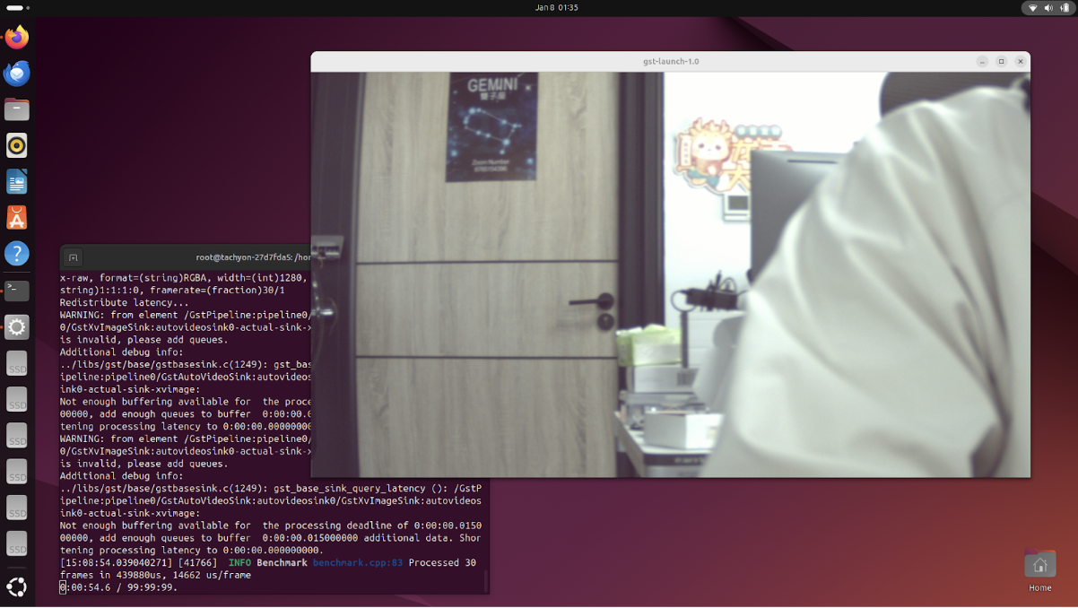

Test that everything works with a live preview:
gst-launch-1.0 -v \
libcamerasrc \
! video/x-raw,format=RGBA,width=1280,height=720,framerate=30/1 \
! videoconvert \
! autovideosink
GStreamer live preview window
