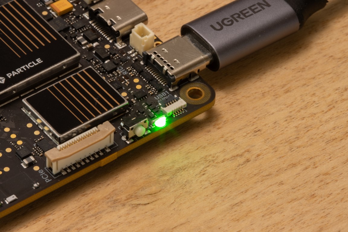

Booting takes about 30 seconds. During this time:
  • The LED will flash green while the system boots.
  • Once it’s fully booted, it’ll switch to a slow green "breathing" pattern.
Tachyon LED Green

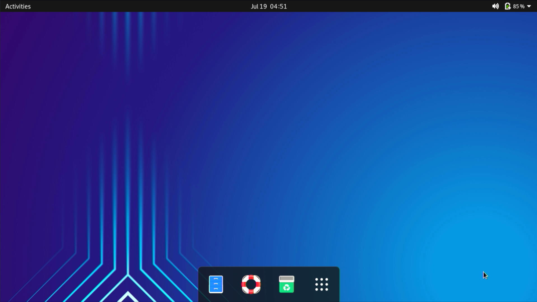

Once logged in, you’ll be taken to the Tachyon Desktop environment.
Tachyon Desktop Home

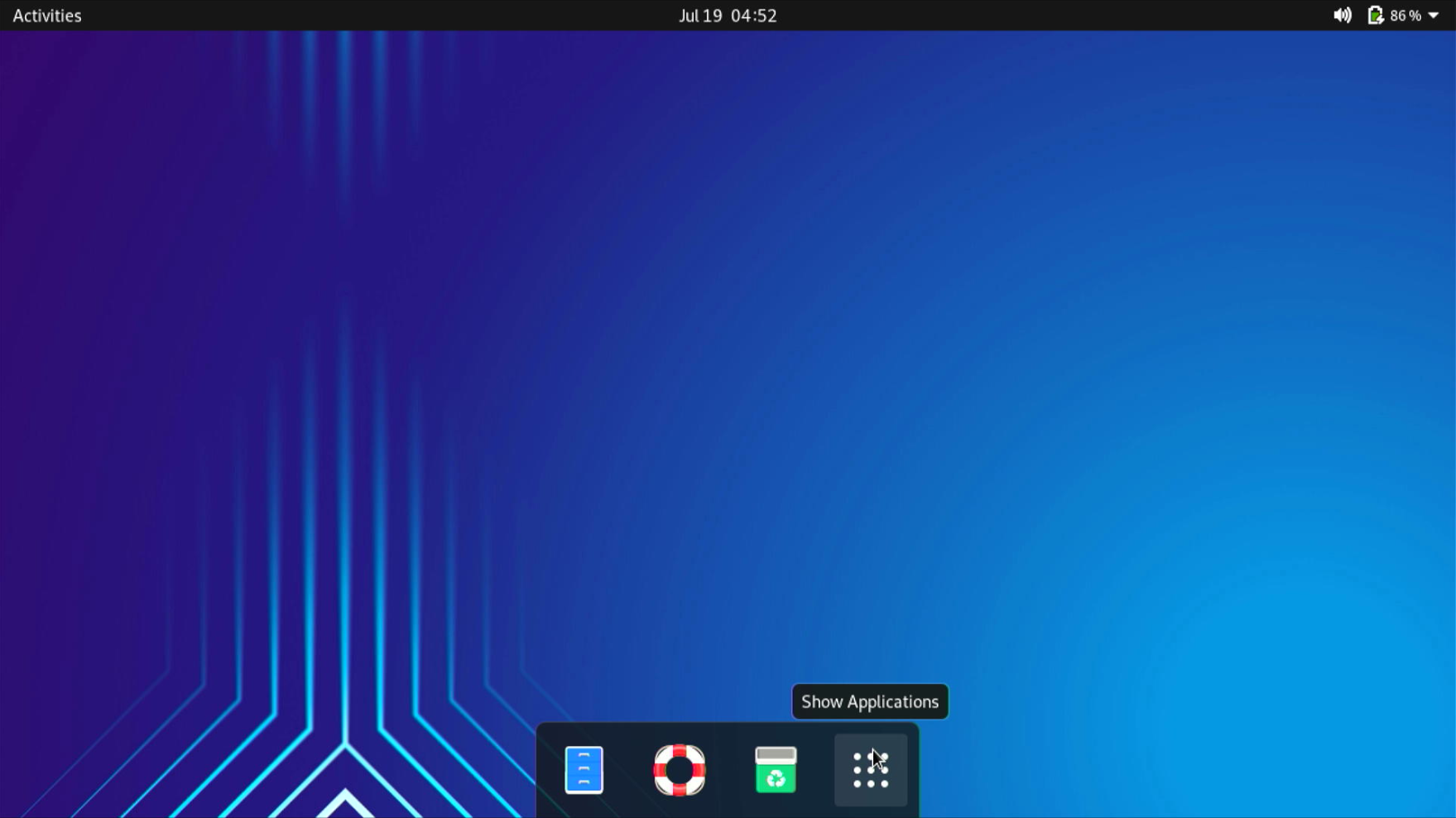

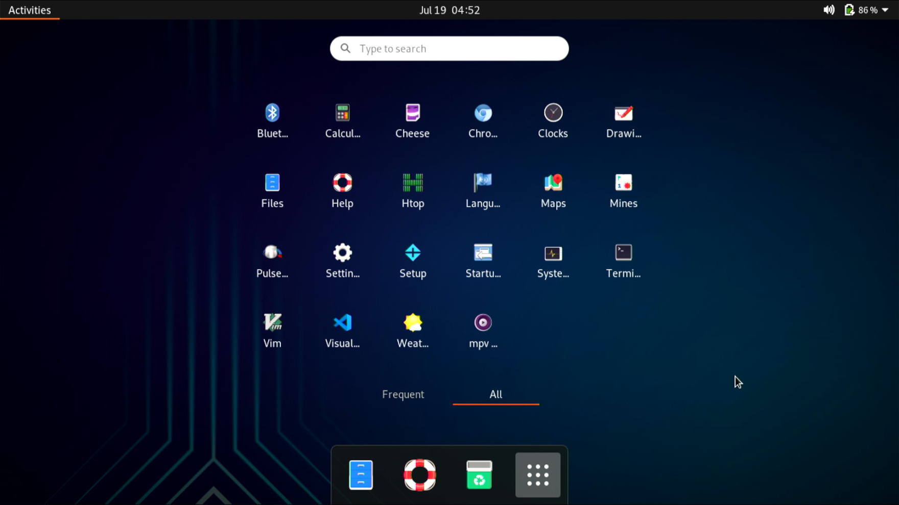

Feel free to explore the Tachyon Desktop environment. We’ve bundled several apps to help you get started. You can access them by clicking the Apps icon in the bottom panel.
Tachyon Apps 1
Included are commonly used Linux applications such as:
  • Vim
  • Chromium Web Browser
  • Cheese (for testing USB webcams)
  • Visual Studio Code
  • Maps
  • ...and many others!
